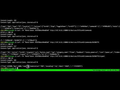

Here’s a tutorial that’s doable if you’re familiar with a command line:
[EDIT: What I neglect to say in the video is that the raw buffer is 0.6sec recording. So reps=10 would be a 6 second transmission. Usually you’d only need reps=2 or reps=3]

I tried the patch commands (I used 3 as the operand) and it does 3 short movements. So … good news: that works, bad news: it changed the reps and not the duration of the rep.

Huh, ok. What’s happening is that there’s some gap of zeros in the data field which the shade is interpreting as a pause between button presses. — You could fix that problem by editing the data field to remove the excessive trailing zeros.
