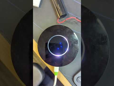

BTW Here’s a video from one of our engineers showing the issue as we observed it. Would be nice to know from @sburke781 @Krustyjonez if your unit does the same LED ring behavior when on the problematic beta.
Yes, mine flickered as well
I signed up just so I could give you feedback on my update situation. Before fully reading the forum I went ahead and tried updating to 3.19.3. I didn’t have a backup, and have never had any problems with any previous firmware update. I’ve owned my Bond for about 4 years. The ID starts with ZZCC.
It ended with a solid white ring and about four solid LED towards the center. Attempts to “white reset” did nothing. “Rescue reset” worked and I have been able to gain control again. With only the hub added in the app I attempted to go to 3.19.3 again with the same results. I noticed progress hung at 88% and the white ring appeared. Eventually the progress “completed” even though the hub seems non-responsive with the white ring.
I was able to “rescue reset” once again, update to 3.17.4 and have re-added my four fans. I’m on android and can’t access the back-up files. I can’t seem to send you a private message, but I will send/post my ID or give more information if you request.
BTW, my update attempts end up similar to your clip.

Mine actually had no light at all. It appeared dead. When I hit reset, it would light the white ring, then the white ring turned off, I could
see the blue leds flash 3x, and I believe it would start again.
Mine was purchased back in 2020… White ring like the video

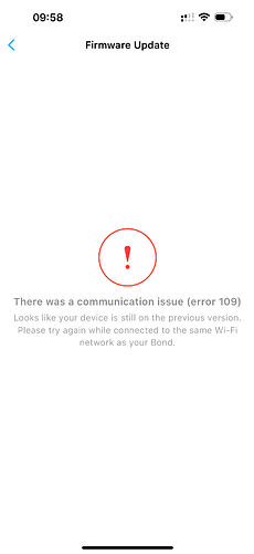

Thanks for keeping us in mind! I tried, it won’t take the firmware update. :frowning:
Stops at 64 %. I would post more screenshots but my account is too new.
Weird. What’s the current firmware version? We did have some internal/alpha versions (v4.0.x) with a serious upgrade problem like what you describe, but no release version (v3.17.4, v3.19.1-beta, etc.) were impacted based on our records.
Actually, it appears to be stuck again and offline/not booting, with just a blue light permanently lit. :frowning:
