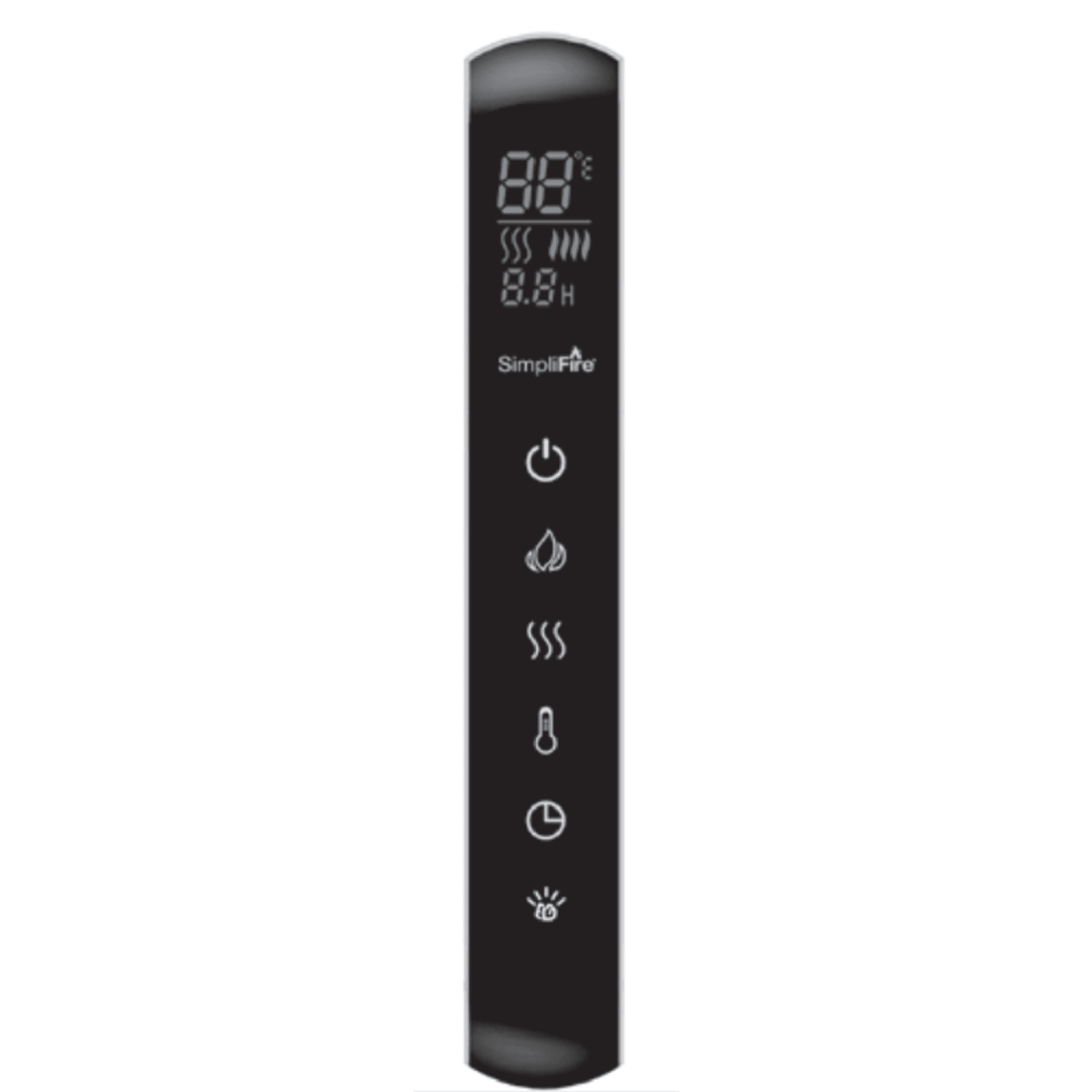

Would it be possible for you to post screenshots of your multiple fireplace setup? I have an electric fireplace (Simplifire Allusion) with an IR remote and I think I have a similar situation - I can create “buttons” to turn it on and off, and one button for on with max heat, but not one for low heat, and I have been unable to change flame color, rock color, fan speed, etc.
Thanks in advance!!

Thanks for sharing the screenshots! I definitely see the logic behind this, and I tried it with mine and it still doesn’t work properly. It’s janky, (I can do flame on/off and fan low on/off and fan high on/off) I don’t know how or why these work but they are… even though I have different “commands” for each.
I notice yours is RF and mine is IR, I wonder if that’s part of the problem…
I’ve attached a pic of my remote mapping so that hopefully someone smarter than me can figure this out. I know it should work, because the Bond is talking to the fireplace, but it’s not quite right
Simplifire Remote
And it kind of works through HomeKit via Hoobs. One of my commands “on with fan low” and “off” work via HK
