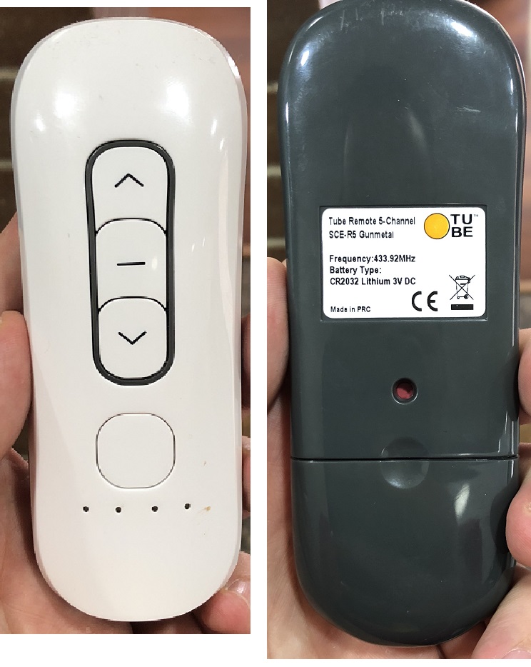

can you record the Remote’s Open/Stop/Close buttons?
Does your remote look like this?
Hi Santiago,
I think we have a hit here
But we need a recording of the remote’s buttons:
Open & Stop and also the Pair button

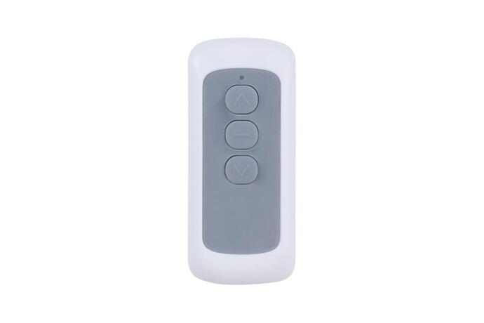

its different. According to the datasheet i think the main difference is that it doesn’t have a preset and its only 1 channel instead of 5

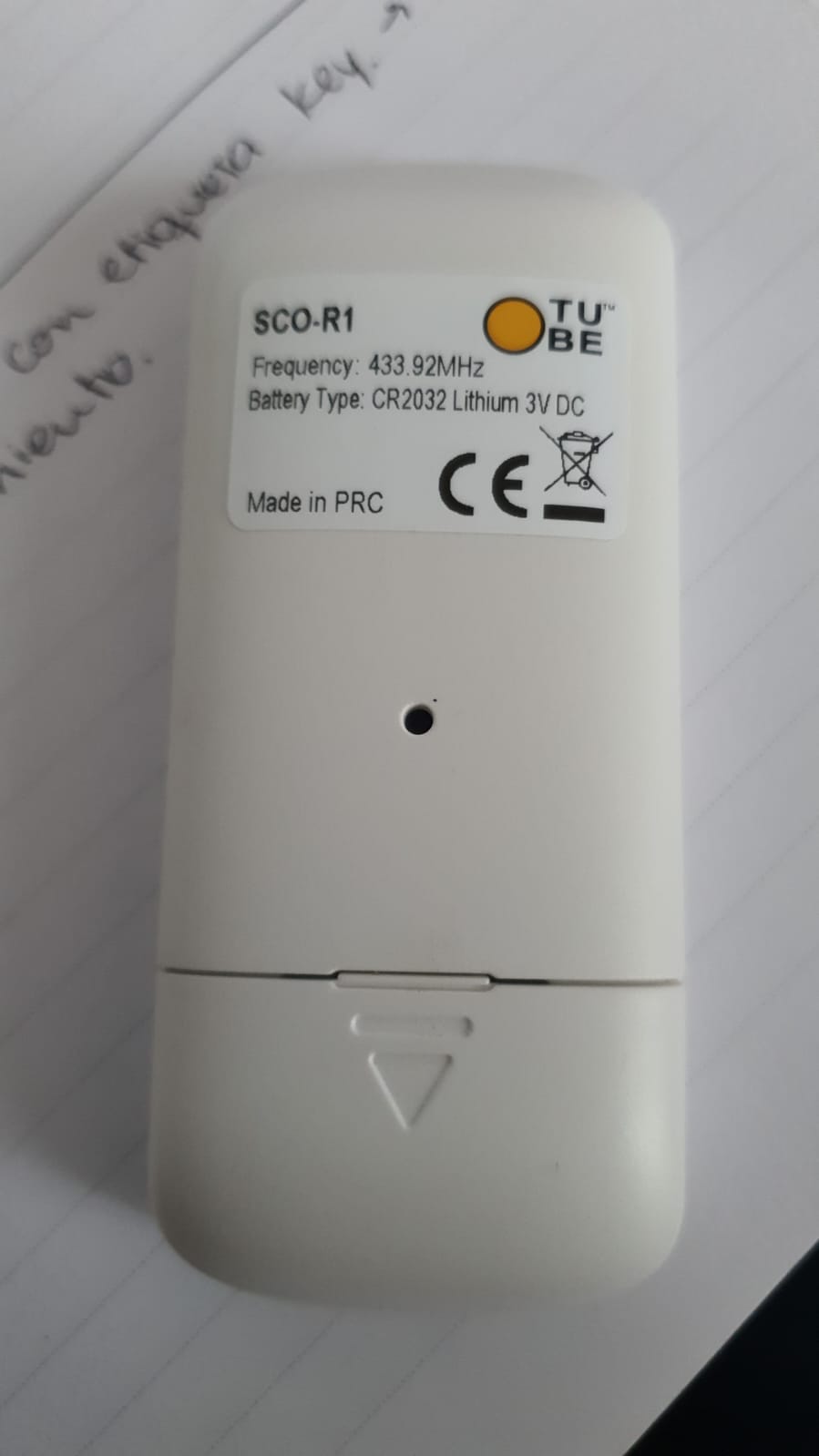

I do have a very similar (or maybe the same) remote for another set of shades sold by the same company a couple of years later (set up on my baby’s bedroom) . I’m almost positive the remotes can work interexchangebly (with the shades set up on the master bedroom where I have the Bond Bridge).
Just letting you know.
Here is a picture.

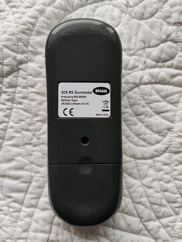

Hey man, Ive got some tubemotors too. Tried with somfy and alpha on the app with no success. Weird thing is that if I press the programming button at the back of the remote my shades enter into some programming mode (they do the up & down thing) but bond cant send any valid command after that… could you manage to get it working finally?
Were you able to find a solution? I have the reggia control, and looking for RF bridge to be able to control them. If Bond works would be great
Sorry to say that with just the codes observed remotely (which two users kindly provided us), we were not able to crack it. We will likely need samples that we can buy in the USA or ship here for testing.
