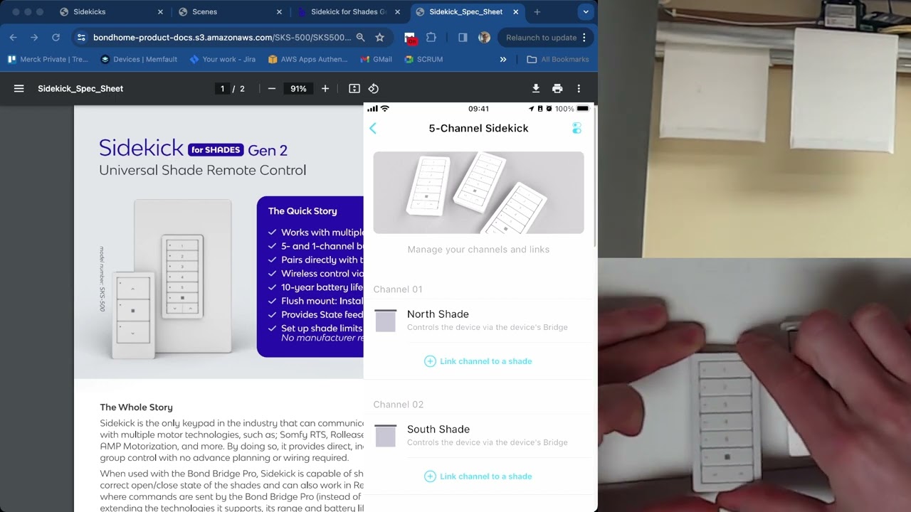

Just published v4.4.1-beta firmware for Bond Bridge Pro. This adds ability to link a Group to a Sidekick channel or key, and a Scene to a key.

We are working on support for this (and Scenes in general) in the app. It’s harder there because the app needs to manage a distributed system. But it is coming. For now you have this web interface if you are willing to put on some CSS-colored glasses :wink:
