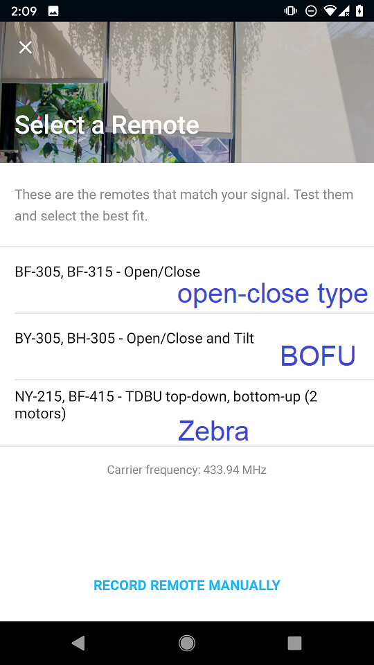

Ok, we’ve never gotten a BF-301 here. Here’s what you can try:
  1. Upgrade your Bridge to BETA firmware.
  2. Try each of the templates below:
  3. If one of these works well, let us know!
  4. If not, then please try manually recording the remote. If you have it working, also let us know. We can read the codes out of your manually recorded device and use it to build a new template.

@merck Hi, I just (finally) got around to testing this. I updated to the beta version and then tried to learn one of the remotes. It found a match with a Dooya remote. This did not work so I went ahead and recorded it manually. I have done some initial testing and it seems to be working well. I have three remotes in my room Home Office, Left Shade, Middle Shade, and Right Shade. This new remote I recorded as Test Left Shade. Should I re-record the existing left, middle and right shade remotes now and delete the test shade? Thanks.
Sure, you can delete the test shade. Glad it worked for you in manual (raw) recording.
