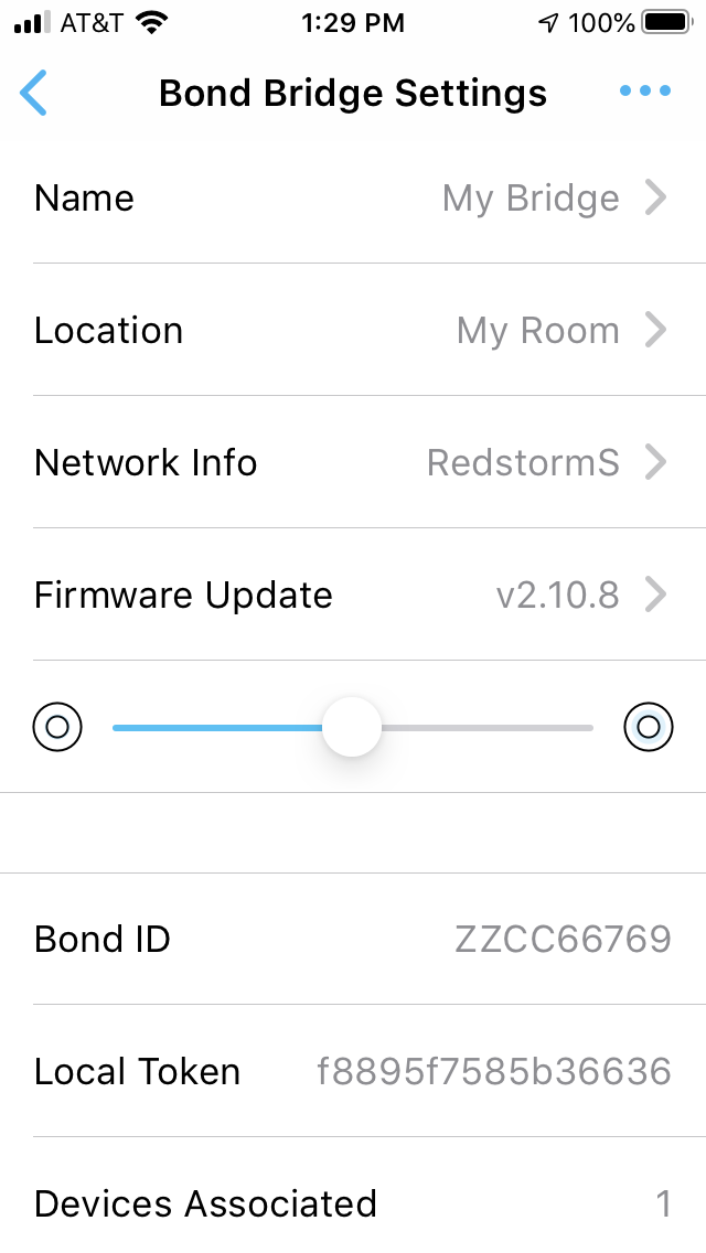

Well the original & desired configurations are history at the moment. I’m trying to start from scratch with a simple single fan. I figure what I learn will apply to the target configuration of 3 fans and maybe new ones I add later. I also hope this helps others.
Below are iPhone 8 screen captures of the Bond Home ap and SmartThings ap. Following that is an image from the ST IDE. As previously indicated, Ceiling Fan does not show up as an icon on the ST ap.
This should give you a view of all aspects of the issue. Again, Thanks for your help! Oh… and HAPPY NEW YEAR!!! :wink:

In a holding pattern until the cavalry arrives. SmartThings ap version 1.6.42, Bond ap version 2.17.3, Bond Bridge firmware version 2.10.8. iPhone 8 with iOS 13.3. No change in environment/status from December. Thanks!
