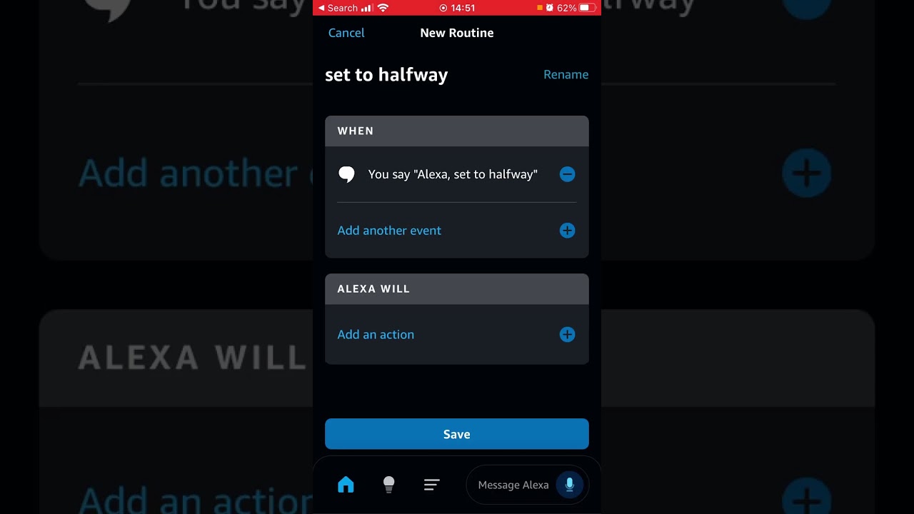

Ok feeling a bit stupid here. I created the scene, which works to stop shades (Yay!!)
How do I call it from an Alexa Routine? I have over 50 routines but can’t seem to find the command.
Hey Joel,
Here’s what it looks like for me. (Pardon the Abby Road reference.)
Perfect! Thanks Chris. Finding Scenes in the stupid Alexa app was a challenge. But it worked! Almost perfect on the first try (opening all shades, then lowering them half way. Just adjusting the timing a bit….
