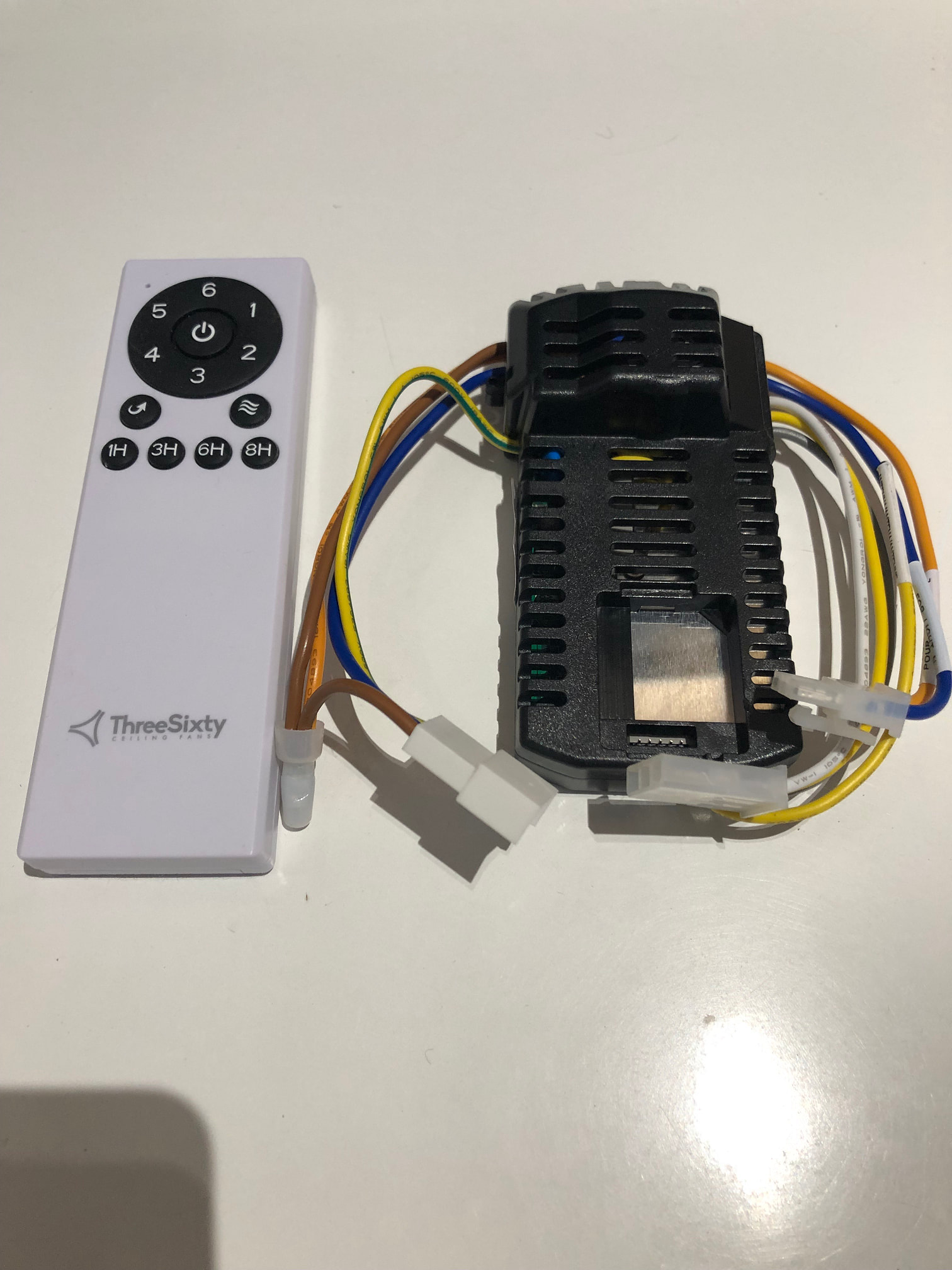

can you share a photo of front & back of the remote of the fan in question? I’ll try to get the info on compatibility
Here’s some photos of the incompatible ThreeSixty Fans remote and control module. ThreeSixty sent me an old control module with the legacy remote that does work with Bond.
Unfortunately they have discontinued this practice, and going forward, their new fans appear to be on an unsupported frequency (2.4GHz?).
Ah, the 2.4 GHz would make sense as why it doesn’t work with Bond. Best route may be to send 360 your feedback that you’d prefer their fans worked with Bond :wink:
