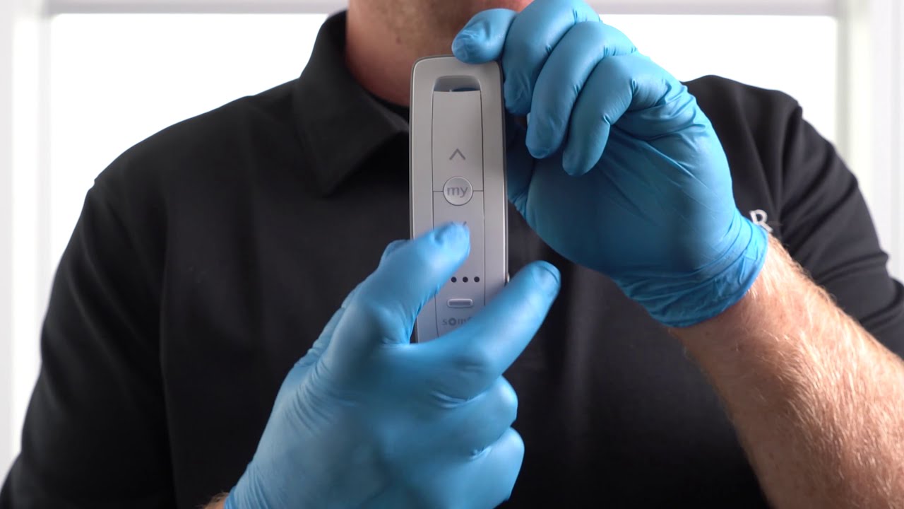

Then, I decided to see if I could control some Somfy blinds. I have 5 Somfy blinds in a room that are controlled with a Situo 5RTS remote. I focused on 1 blind and started the process. I got the blind to jog and then went through the pairing process. Initially it seemed to work but then it did not respond to the Bond Device controls at all. So I decided to delete the Device. Seeing the warning that I needed to unpair the Device before deletion, I followed the steps to do that before I deleted it.
My issue, after doing this, is that the blind is now completely unresponsive! Pressing the programming button on the back of the remote no longer causes the blind to jog. In addition, the remote no longer controls the blind.

Here are the instructions for *Reset All Communications Between the Motor and Remote Transmitter" (taken from Sunsetter owners manual.)
2. Press and Hold the my button; the red LED light will blink for at least 5 seconds, then release.
3. Disconnect Power (at the Wall outlet) for 5 full seconds.
4 Connect Power (at the Wall outlet) for 10 full seconds.
5. repeat step 3.
6. Connect Power (at the Wall outlet). Your shade should move then stop on its own.
7.Press and hold the “Programming” button for 10 seconds, watching for two separate jogs back and forth, several seconds apart.
8. Press and Hold the “UP” and “DOWN” buttons together until your shade jogs. Note: the shade now moves ONLY by holding down the “UP” or “DOWN” button.
Good luck
Thanks! NB: these instructions are for AC motors. The battery motors will have a different procedure.
Given that the DC logic will be most likely the same for both types of motors, the reset process will not be that different. The AC power - power off pattern is much more like a battery connect and disconnect for the logic involved. Let’s see what the process actually is.
Just found a YouTube describing Programing Somfy Wirefree and Somfy RTS Motors
