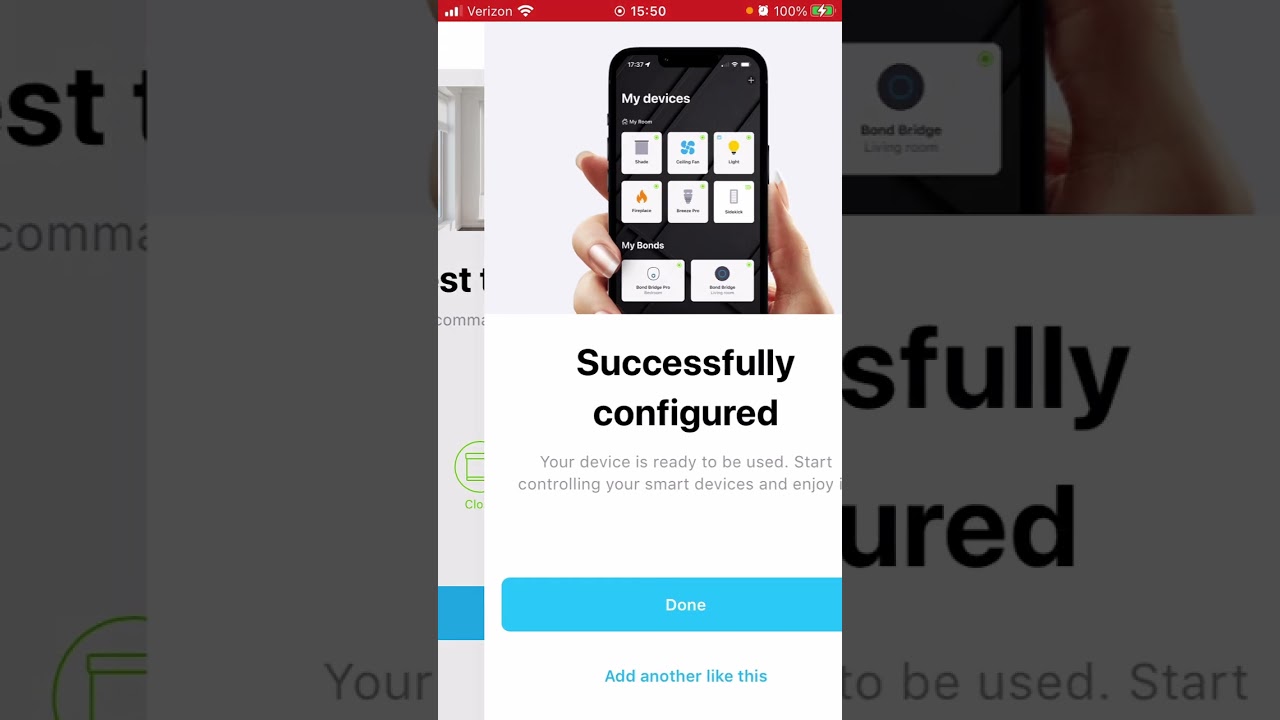

I should note that we have indeed reproduced an issue with AMP motors and the Bond Bridge where they don’t seem to like the slider. In fact, the motors hate it :smiling_imp: and they implicitly become unpaired upon receiving a slider command. We’ve got a workaround though:
Just select AMP instead of Rollease in the setup flow.
