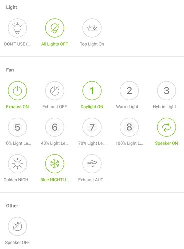

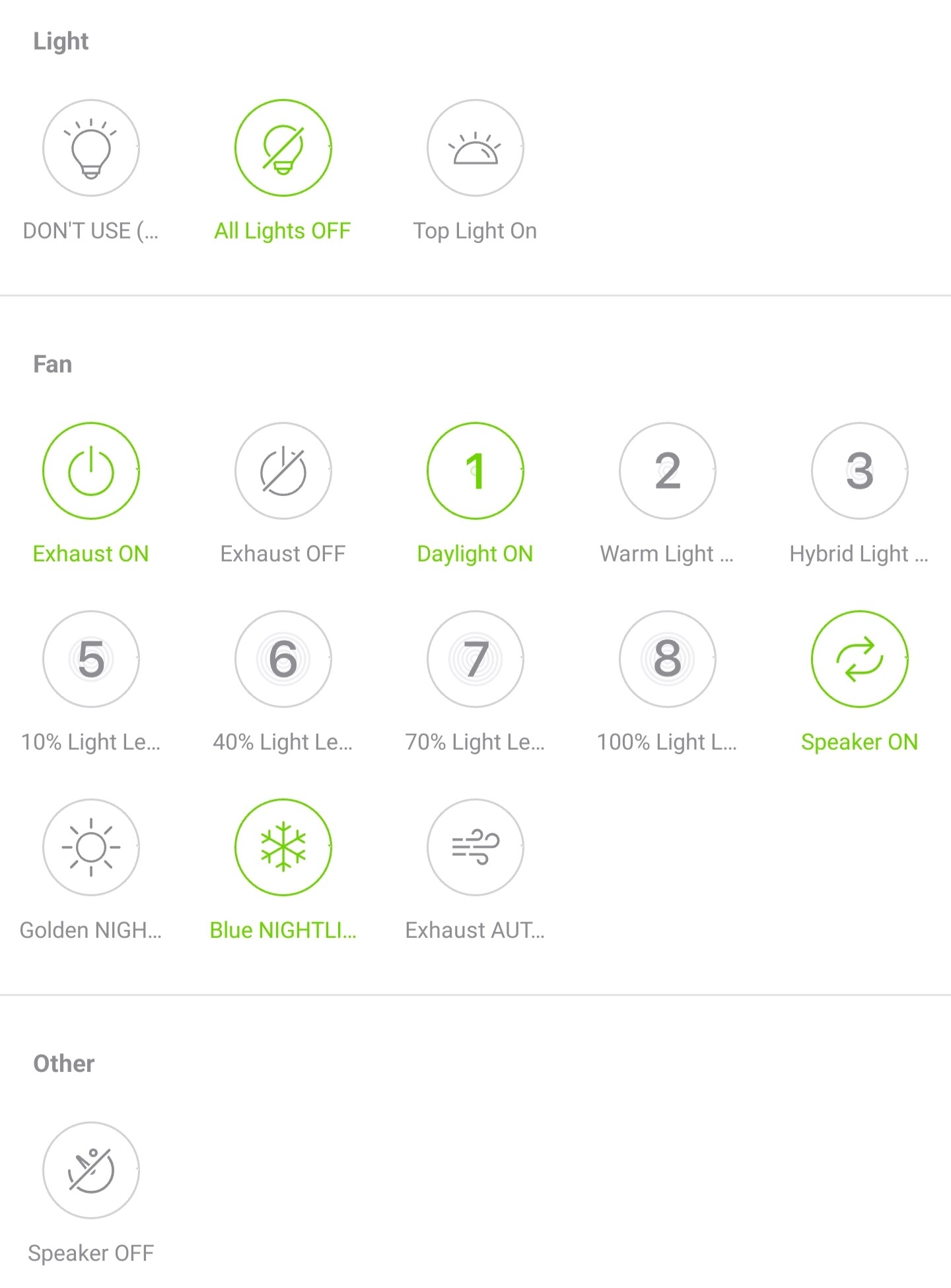

As an example, I have a “ceiling fan” type device I raw-recorded which has many functions for lights, fan and speaker.
It is a bathroom exhaust fan with two different lights and the fan itself, plus a Bluetooth speaker.
While I can record commands for all of the OEM buttons, it does require using what would normally be “fan” commands to give additional buttons for commands that actually control lights or speakers.
I am slowly duplicating the same Device and its Signals with different Actions that allow me to assign the Category Name, unlike what I can do with the original raw-recorded Device. Sure, I can rename the Command without seemingly any limitations, but the icon slugs and Category Names seem hard-set or limited by the type of Action to which the Command is assigned.
Original Raw-recorded, showing a mixture of “fan” and “light” named commands in the Fan section:
Slowly created Commands using the same Signals as above via API in a duplicate Device, so at creation they are associated with a “light” type Action:
Personally, I’d like to separate these into two distinct Categories - one called “Main Light” and one called “Night Light” (both of which would have a copy of a Command called ‘ALL Lights Off’ or similar which actually each sent the same Signal), but at least this is closer to what I want. :smiley:
